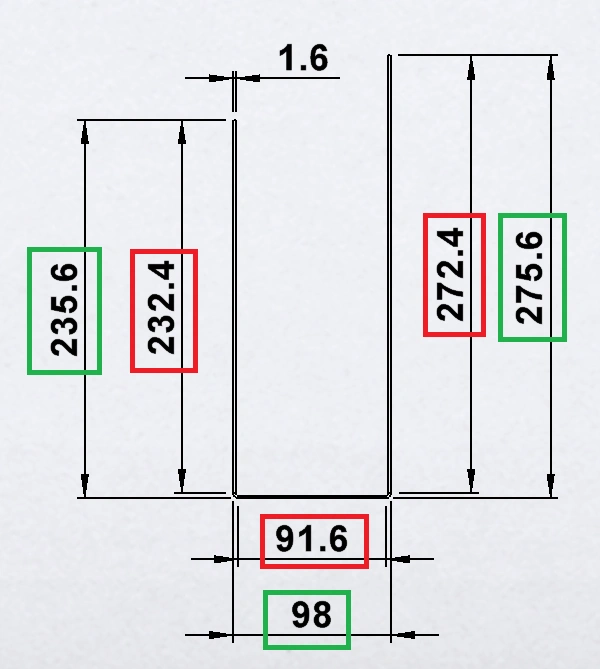

I am seeking your guidance regarding an issue I am facing. Currently, I manually add dimensions to folded views in my daily work, and I am attempting to automate this process using the macro outlined below.
The macro successfully adds the dimensions (highlighted in red), but my requirement is for it to include the overall dimensions, including the arc (highlighted in green).
Could any expert kindly assist me in resolving this issue? Your support would be greatly appreciated.
Thank you in advance for your time and help.

This macro adds overall Dimensions to a Part in views.  You can call it from your current macro using ISldWorks.RunMacro2.  See video below.  The zip file contains the macro and a toolbar button, written in SW2021.
FYI, it will not work on parts that are only circular, for example a disc.

Thank you for your reply. I tried your macro and made the updates as suggested, but unfortunately, it still does not meet my requirement.
In my case, I am working with sheet metal parts of various shapes (please see the attached files), and I need to dimension every flange-to-flange. This is a critical requirement for bending operations.
Do you see any possibility of assisting me in achieving this requirement? Your guidance would be greatly appreciated.
Thank you for your time and support.

   Dim key As String
   Dim swComp As SldWorks.Component2
   Dim i As Long, j As Long
   Dim verts(1) As SldWorks.Vertex
   Set dict = CreateObject("Scripting.Dictionary")
   Set swComp = swView.RootDrawingComponent.Component
   ' Get visible edges in the drawing view
   vbEntities = swView.GetVisibleEntities2(swComp, swViewEntityType_Edge)
   If Not IsEmpty(vbEntities) Then
       For i = LBound(vbEntities) To UBound(vbEntities)
           Set swEntity = vbEntities(i)
           If TypeOf swEntity Is SldWorks.edge Then
               Set edge = swEntity
               ' Collect start and end vertices
               Set verts(0) = edge.GetStartVertex
               Set verts(1) = edge.GetEndVertex
               For j = 0 To 1
                   Set vtx = verts(j)
                   If Not vtx Is Nothing Then
                       key = Format(vtx.GetPoint(0), "0.000") & "," & Format(vtx.GetPoint(1), "0.000")
                       If Not dict.Exists(key) Then
                           dict.Add key, vtx
                       End If
                   End If
               Next j
           End If
       Next i
   End If
   GetOuterVertices = dict.Items
End Function
' Add left dimension
Sub AddLeftDimension(swView As SldWorks.View)
   AddVerticalDimension swView, True
End Sub
' Add right dimension
Sub AddRightDimension(swView As SldWorks.View)
   AddVerticalDimension swView, False
End Sub
' Add bottom dimension
Sub AddBottomDimension(swView As SldWorks.View)
   AddHorizontalDimension swView, True
End Sub
' Add top dimension
Sub AddTopDimension(swView As SldWorks.View)
   AddHorizontalDimension swView, False
End Sub
' Add vertical dimension helper
' If isLeft = True ? left edge, else right edge
Sub AddVerticalDimension(swView As SldWorks.View, isLeft As Boolean)
   Dim swApp As SldWorks.SldWorks
   Dim swDrawing As SldWorks.DrawingDoc
   Dim swMathTransform As SldWorks.MathTransform
   Dim vbVertices As Variant
   Dim swVertex As SldWorks.Vertex, swMathPoint As SldWorks.MathPoint
   Dim swVertexLower As SldWorks.Vertex, swVertexUpper As SldWorks.Vertex
   Dim swMathPointCheck As SldWorks.MathPoint
   Dim vbVertex As Variant
   Dim swEntity As SldWorks.Entity
   Dim swSelectData As SldWorks.SelectData
   Set swDrawing = swApp.ActiveDoc
   Set swMathTransform = swView.ModelToViewTransform
   vbVertices = GetOuterVertices(swView)
   If UBound(vbVertices) < 0 Then Exit Sub
   ' Find lower vertex
   Set swVertex = vbVertices(0)
   Set swMathPoint = swApp.GetMathUtility.CreatePoint(swVertex.GetPoint).MultiplyTransform(swMathTransform)
   Set swVertexLower = swVertex
   For Each vbVertex In vbVertices
       Set swMathPointCheck = swApp.GetMathUtility.CreatePoint(vbVertex.GetPoint).MultiplyTransform(swMathTransform)
       If swMathPointCheck.ArrayData(1) < swMathPoint.ArrayData(1) Or _
          (swMathPointCheck.ArrayData(1) = swMathPoint.ArrayData(1) And _
           ((isLeft And swMathPointCheck.ArrayData(0) < swMathPoint.ArrayData(0)) Or _
            (Not isLeft And swMathPointCheck.ArrayData(0) > swMathPoint.ArrayData(0)))) Then
           Set swVertexLower = vbVertex
           Set swMathPoint = swMathPointCheck
       End If
   Next vbVertex
   ' Find upper vertex
   Set swVertexUpper = swVertex
       If swMathPointCheck.ArrayData(1) > swMathPoint.ArrayData(1) Or _
           Set swVertexUpper = vbVertex
       End If
   Next vbVertex
   ' Select and add dimension
   swDrawing.ClearSelection2 True
   Set swSelectData = swDrawing.SelectionManager.CreateSelectData
   Set swEntity = swVertexLower: swEntity.Select4 True, swSelectData
   Set swEntity = swVertexUpper: swEntity.Select4 True, swSelectData
   If isLeft Then
       swDrawing.AddVerticalDimension2 swView.GetOutline(0), swView.Position(1), 0
   Else
       swDrawing.AddVerticalDimension2 swView.GetOutline(2), swView.Position(1), 0
   End If
   swDrawing.ForceRebuild3 True
End Sub
' Add horizontal dimension helper
' If isBottom = True ? bottom edge, else top edge
Sub AddHorizontalDimension(swView As SldWorks.View, isBottom As Boolean)
   Dim swVertexLeft As SldWorks.Vertex, swVertexRight As SldWorks.Vertex
   ' Find left vertex
   Set swVertexLeft = swVertex
       If swMathPointCheck.ArrayData(0) < swMathPoint.ArrayData(0) Then
           Set swVertexLeft = vbVertex
       End If
   Next vbVertex
   ' Find right vertex
   Set swVertexRight = swVertex
       If swMathPointCheck.ArrayData(0) > swMathPoint.ArrayData(0) Then
           Set swVertexRight = vbVertex
       End If
   Next vbVertex
   Set swEntity = swVertexLeft: swEntity.Select4 True, swSelectData
   Set swEntity = swVertexRight: swEntity.Select4 True, swSelectData
   If isBottom Then
       swDrawing.AddHorizontalDimension2 swView.Position(0), swView.GetOutline(1), 0
   Else
       swDrawing.AddHorizontalDimension2 swView.Position(0), swView.GetOutline(3), 0
   End If
End Sub
