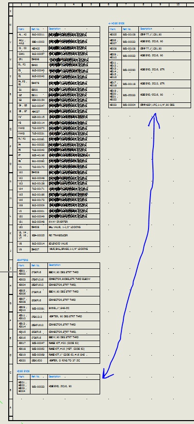

I needed to create a list of hose ends and adapters for a hydraulic assembly. To do so, I generated a custom report that breaks based on component location. All adapters are under location "ADAPTERS" and all hose ends are under location "HOSE ENDS". It generated successfully, except the "HOSE ENDS" report breaks at the bottom of the page, and picks back up at the top of the page with the heading "-> HOSE ENDS". Is there a way to keep these two tables combined as one, instead of breaking at the bottom of the page?
