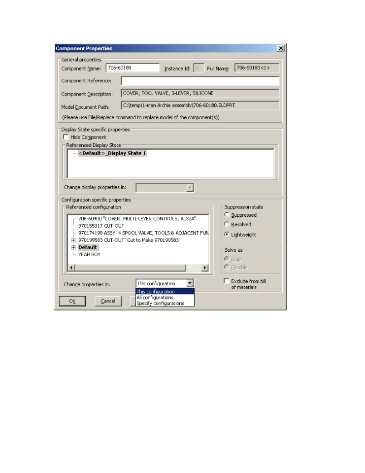

One other matter with configurations; if I'm working in an "assembly" which has a handful of configurations, and I wish to change a "component config" within the different assemblies, I'm given the option to choose which configs I want this to take place in, or select "all configs", but this does not follow through truely either.  I wind up needin to go to each assembly configuration and having to set the component config there.  (see "change properties in:" below)
