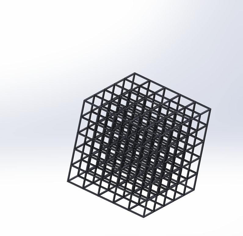

I have created a basic elementary cellular structure 1x1x1cm.
Then I applied a repetition function along the X and Y axis to obtain the this part below :
Next, I want to apply another repetition function along the Z axis to obtain a cellular structure of 5x5x5cm.
But, to apply the repetition function, I have to select all the 25 cubes above one by one.. It can't be chosen automatically at one.. After my previous repetition function, it does not become one merge part.
So my question, how can I apply this repetition function along Z, when selecting part to be repeated, I don't need to choose each one. I can just click and select the part above straight away.
Thank you.
And more importantly, how can I select these in macro so that everytime it will automatically choose the part to be repeated, even when the dimension changes.
This is the final part that I want to obtain :
