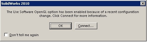

I looked at the device manager of the remote machine to see what kind of video card it had.  All it said was "Standard VGA Graphics Adaptor".  I confirmed with the IT guy and he said it actually had a AMD FirePro V5900 in it.  So, I asked him to load the certified drivers for it.  He complied but said he had a lot of problems getting them loaded (not sure what that means exactly).  Now, when I look in the device manager, it shows an "ATI FirePro V (FireGL V) Graphics Adaptor" with the correct driver for this machine installed.  I haven't even got to do any more testing yet tho.  The next time I started SolidWorks on the remote machine, I got the following error.

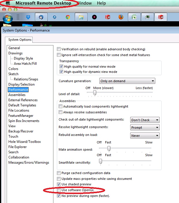

The Software OpenGL is turned on and shaded out.  I've done some research on this and tried a couple suggested fixes for this.  But none have worked yet.  Would running SolidWorks remotely force the Software OpenGL to turn on?  I can't see why it would since it it using the hardware of the remote machine, and only projecting the image through remote desktop.  But I'm not positive.

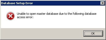

  2. In the system options, whenever I click Hole Wizard/Toolbox on the left, again, everything freezes for several minutes and I eventually get the message following message:
    1. I have confirmed the correct path and the presence of the toolbox database.
