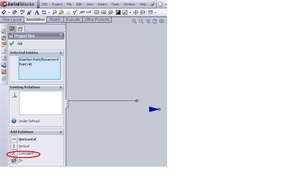

Dear All,
I want to select block endpoint & line end point to form coincident relation
I am unable to do this.
please guide me for the same
snap settings  are on
here is code for your ref.
swModel.Extension.SelectByID2 s1, "SKETCHSEGMENT", 0, 0, 0, False, 0, Nothing, 0
        s1 = "Line" & "" & swSketchSeg.GetID(1)
        Set swSketchSegment = swselmgr.GetSelectedObject6(1, -1)
            Set swStartPt = swSketchSegment.GetStartPoint2
            Set swEndPt = swSketchSegment.GetEndPoint2
            x1 = 0
            y1 = 0
            x2 = 0
            y2 = 0
            x1 = (swStartPt.x)
            y1 = (swStartPt.y)
            x2 = (swEndPt.x)
            y2 = (swEndPt.y)
            ang = (swSketchSegment.Angle)
            nPt(0) = x2
            nPt(1) = y2
            nPt(2) = 0
            vPt = nPt
Set swSketchBlockDef = swSketchMgr.MakeSketchBlockFromFile(swMathPoint, "C:\\"test.SLDBLK", False, 1, ang)
swModel.Extension.SelectByID2 "", "SUBSKETCHINST", vPt(0), vPt(1), 0, False, 0, Nothing, 0
swModel.Extension.SelectByID2 "", "SKETCHPOINT", vPt(0), vPt(1), 0, False, 0, Nothing, 0
swModel.SketchAddConstraints "sgCOINCIDENT"
