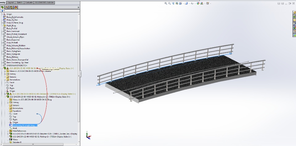

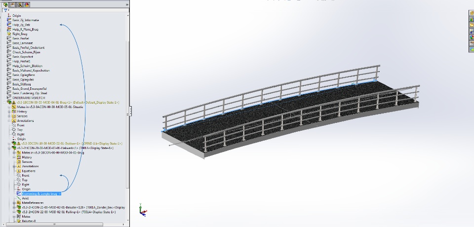

Hello,
I have made a quite complex assembly. I have started to update it with 2 configurations and a design table.
I didnt explected my strobble with my reference geometrie, but this it where it fails.
When i switch configurations 1 reference from my top assembly to a lower assembly breaks. All other references (and parts/assemblies) keep working fine.
I have added 2 files, In Configuration 1 the reference is just fine, In Configuration 2 it fails. The deck updates, the railing doesnt...
Dont mind the yellow, i have deleted other stuff it is complaining about:P
Anyone knows if this is a bug or something else?
Regards,
Koen
