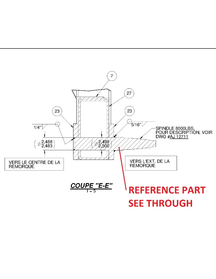

Hi,
I have a weldment part in which a spindle is welded in a hole.  I made a section view of this portion of the part in the drawing environement.  So, the frame and the spindle are sectioned.  I would like to change the spindle as a reference part so I can see the frame through it, add the appropriate welding notes and by the way, be able to put dimensions on the holes that will receive the spindle.  The spindle must be a reference part so the guy who read the drawing in the shop will understand that something goes in these holes.  you can take a look at the pic!
