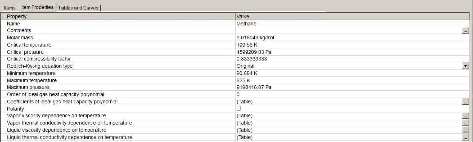

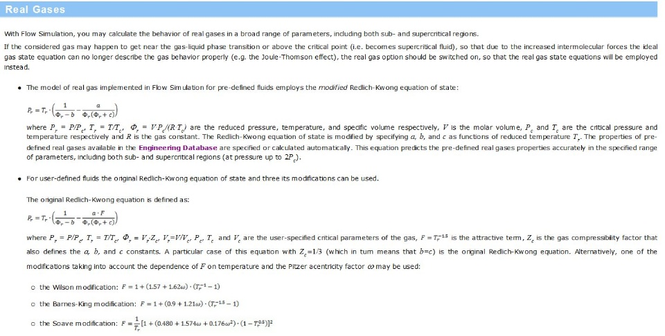

Anyway, in the help manual describing the equations used there is a statement that says "Real Gases
Pc, Tc  and Vc are the user-specified critical parameters of the gas, F=Tr^-1.5 is the attractive term, Zc is the gas compressibility factor that also defines the a, b, and c constants." Reference the attached image.
In the engineering database, Vc  is not a user-specified critical parameter. The critical parameter should be compressibility, Zc? Again Reference the below picture. Let me know what you think..
