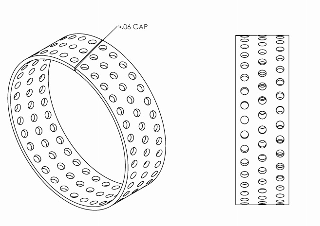

I am trying to recreate a part that has a gap at a angle as opposed to a straight line. I then want to unfold and place the holes into the part, pattern and fold the part again. The problem is whenever I create the part and got to unfold it, It produces a error that say you cant get a fixed edge from a non planar surface. I then tried to do a lofted bend. This has yielded no positive result as the part has a v shape when it should have a cylindrical shape. Anything would be helpful. I have tried this 3 different ways and have exhausted all of my options.
