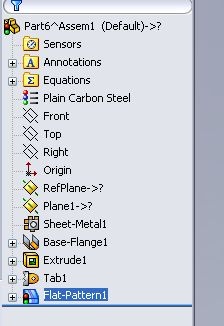

I am trying to flatten a part with vb.net and I have the code in a dll, it flattens and then the rebuild flag appears by the in the feature tree. I can cannot get it to update so that the part actually flattens.

Just cannot get it to work.
Note: this works just fine if the code is in an exe or a macro.
