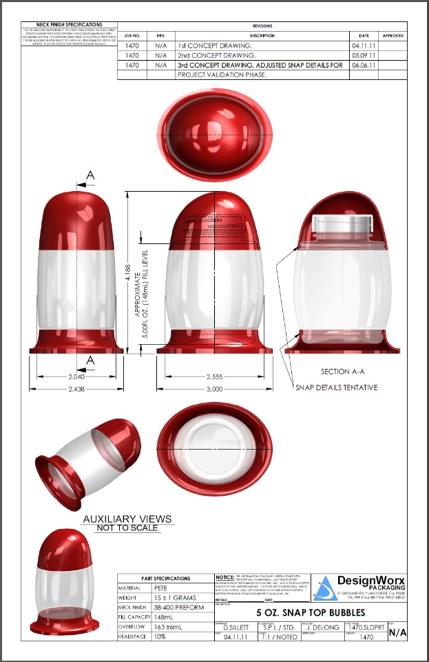

Hey all, I just noticed a change in SW that I'm not thrilled about. I used to be able to apply textures to my parts with RealView turned on and have them show up very similarly in my drawing views. I could create .PDF files and send my customers drawings with shading that looked more realistic than if RealView was turned off.
I just went to create another drawing, and all of the sudden, no matter whether or not I have RealView turned on, the shading on the drawing views show up as if RealView is turned off.
I even tried opening drawings where I was previously successful with this, and now they no longer display correctly either. (
See attached for a file I created in the past without issue.)
I spoke with tech support as I was having trouble getting a polished gold texture to come up in my drawing view with RealView on in my model, and he told me ReralView isnt supported in drawings at this point. I found this puzzling as I've been able to make my drawing views reflect what my model looks like in it's current state in the past.
Any ideas what's going on here?
