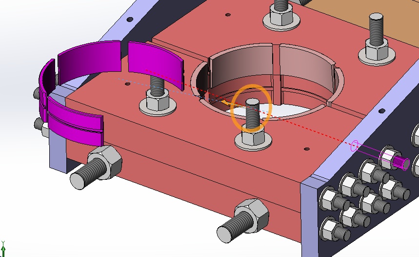

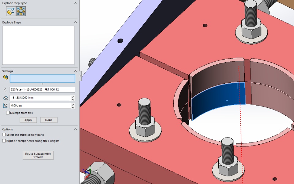

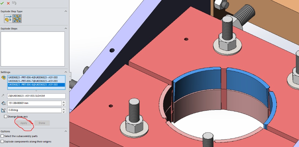

Solidworks 2018: I am trying to radially explode some components that are placed around a cylinder but it won't give me the option to explode them when i select them, if I try to force the correct explode axis by selecting the cylinder it just deselects my components. I can select certain other components in the assembly with this forced axis and they will explode fine though, or I can select an axis through one of those other components and the components i want to explode with explode about that axis, but this isn't the one i want... any thoughts?

Cannot change axis or select apply.
Axis selected but now can't select my components:

Can select axis from something else and my components will explode, albeit not exactly how I want:
