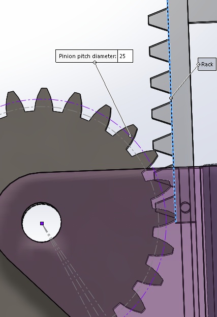

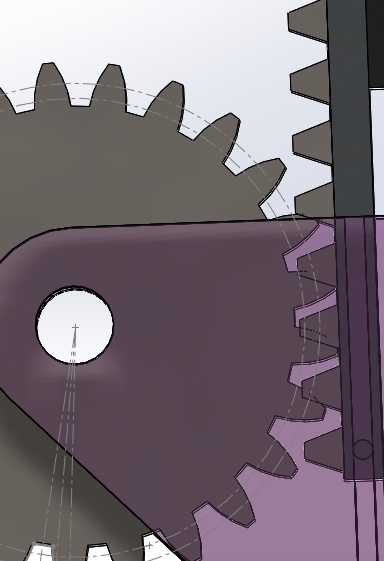

Hello,
Im trying to do a Rack and Pinion mate.
I have a pinion mod 1 with 25 teeth.
a Rack Mod 1 with a Pitch height 1 .
The distance between the center of the pinion and the bottom of the rack is 13.5 mm
The problem is that the meshing of the two components doesnt seem good.
Im not sure i have the distance right and that might be the problem.
Any ideas what could be wrong here?
