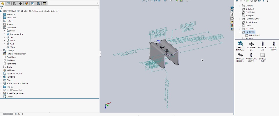

My engineering team has been building out a custom design library full of features that we commonly draw for our products. The next thing we're trying to do is add dimensions or dimxpert details to these features so they are "predetailed" when dragged into a drawing.

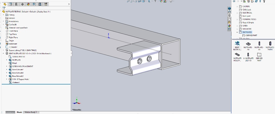

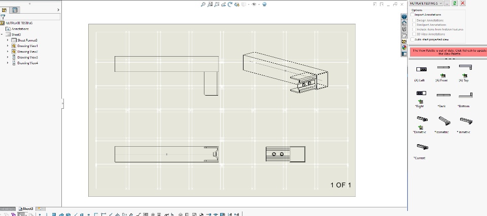

Once a design library feature is dragged onto a part, it looks like there is no way to display any dimensions saved inside the feature.
Are we missing something, or perhaps going about this the wrong way?
