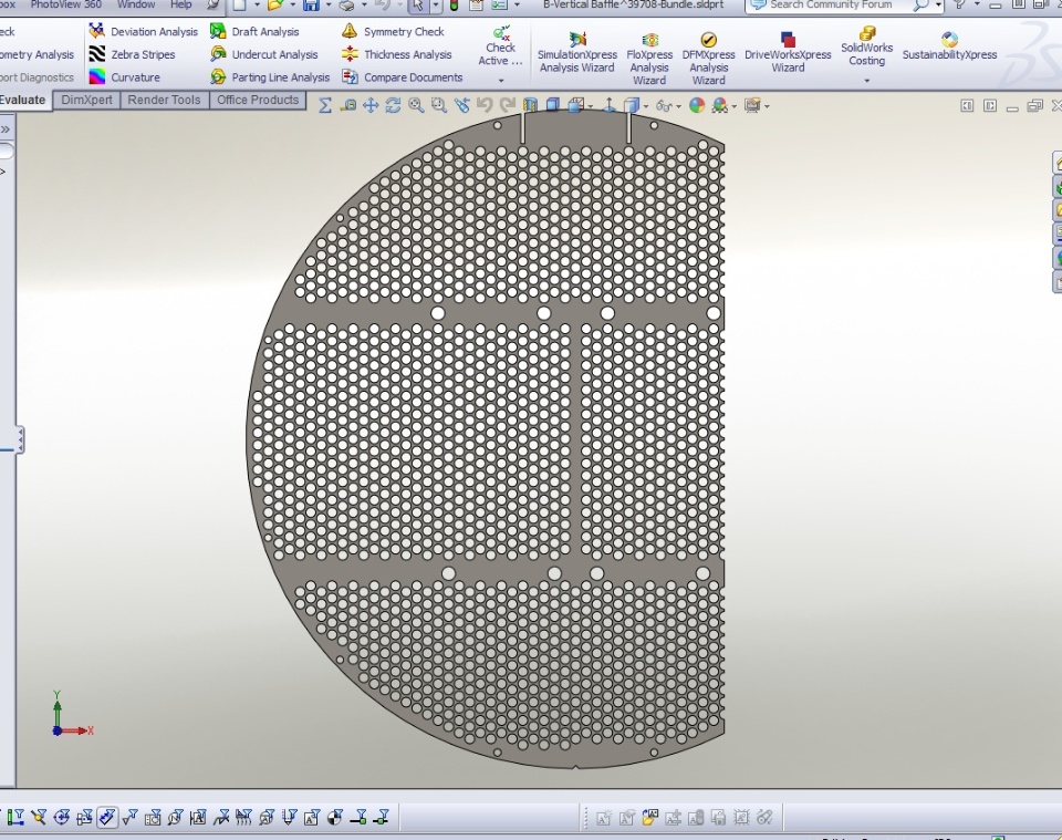

With the part in question below, what would be the quickest way for me to be able to count the number of holes in this plate.
Is there any way to highlight a circular edge, and then select similiar edges by diameter or size, much like you can in autocad?
We work with parts similar to this all the time, and I am still searching for a more effiiecent way of getting number totals. The holes are punched with a cavity, so no pattern exists within the part.
Right now I have to highlight a group of edges and use the CHECK command in Evaluate, and then carefully de-select edges I do not want included in the count. This proves to be pretty time consuming.
