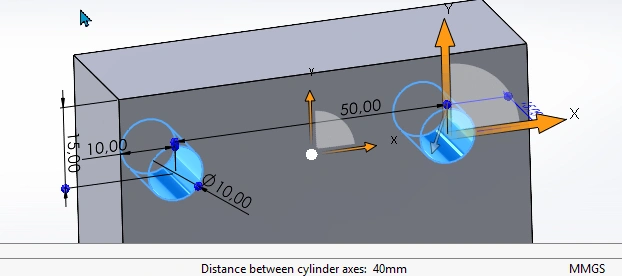

Hi all,
I noticed that the quick measure (click/control-click one or multiple elements and check the Status-bar) shows incorrect dimensions when measuring between cylinders or arcs:
It seems to display the minimum distance (50-(r1+r2)) instead of the center-to-center-distance it would normally show.
This changed after updating from 2025SP0 to 2025 SP1.2. There's nothing in the hotfixes for SP1.2 that looks like it might fix this.
