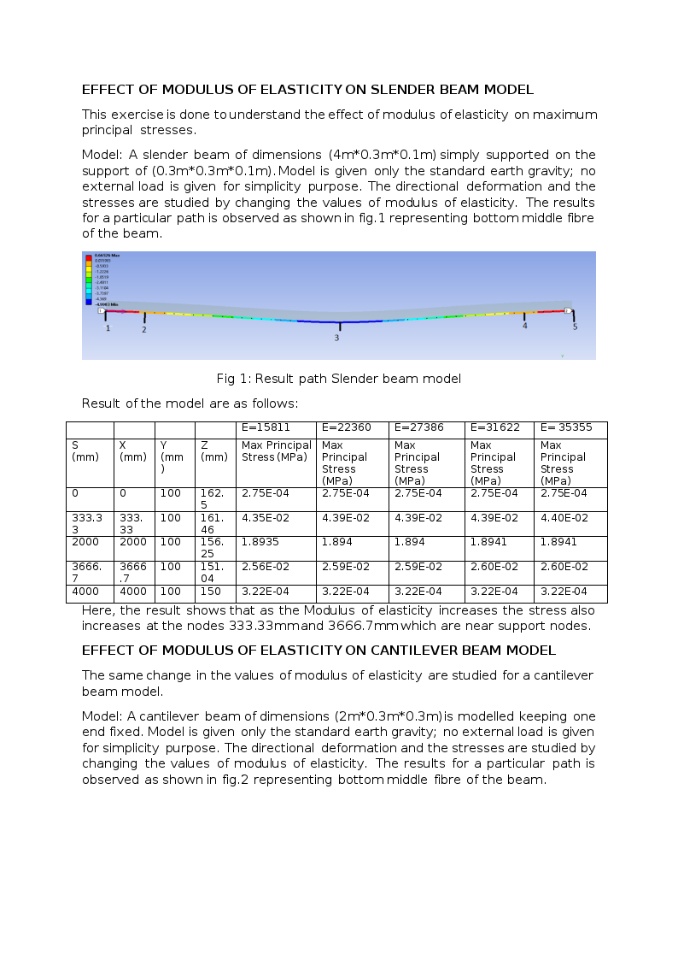

I am trying to study the relation between modulus of elasticity and the stress. Two models are prepared one simply supported beam and another one is cantilever beam. Result for simply supported beam shows that as the Modulus of elasticity increases the stress also increases, But for cantilever beam no change in stress occur. Why the results differ and what is correct co-relation between them?
