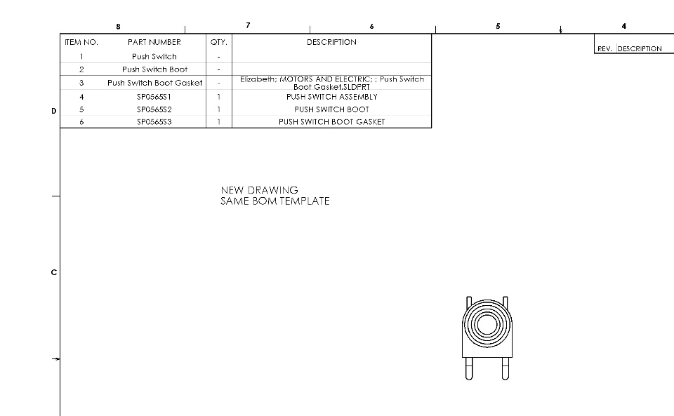

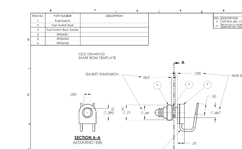

I've got an old assembly drawing that I'm updating. While I was at it, I wanted to get rid of the old Excel BOM and insert a SW BOM. I'm using the exact same BOM template that I've been using for a very long time, and never had problems with it. But this time, the QTY column is missing, and the description column does not populate. I can't figure out why.
I did some testing by inserting the exact same assembly into a new drawing, and using yet again the exact same BOM template. The BOM in the new drawing displays everything correctly.
I compared the Document Properties>Tables>Bill of Materials between the old and the new drawing, and they are identical.
I've compared the Bill of Material settings on the property tab between the old and the new drawing, and they are identical as well.
Does anyone have any clue what is causing this. I feel like its probably something simple that I'm overlooking. Refer to the pictures for further explaination.
