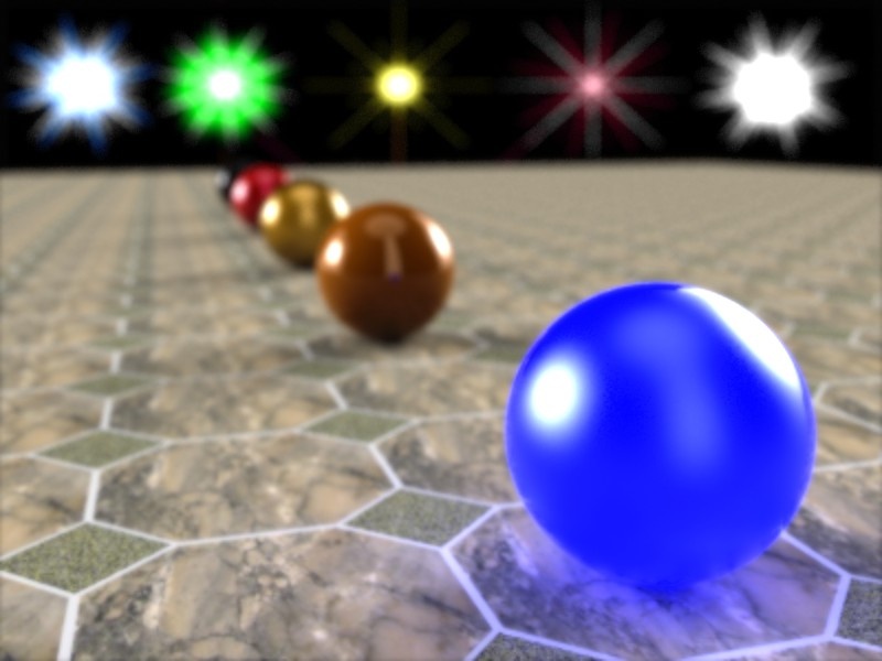

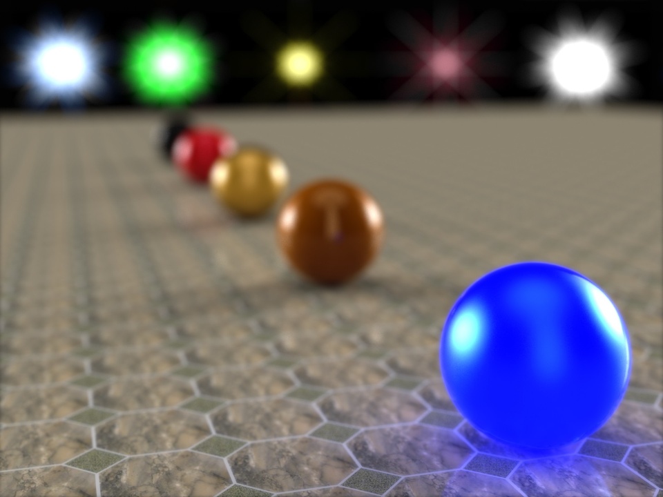

Anyway I setup a scene in SW 2010 PV 360 and I got the result I wanted.  I copy the files to a new directory open them up in SW 2011 and try to recreate the same scene. I am very disappointed, that I can't and I don't know what I am doing wrong.
1) Some of the appearances in 2010 PV 360 are not in the 2011 version, which I don't understand why they would have been removed. (FYI it was a 3D floor tile appearance)
2) I have a Camera setup sitting in nearly the same respect as my other camera in 2010. The Depth of Field is set to the same location with the Same Focal distance yet the depth of field is incorrect compared to 2010.
3) Bloom I have this turned on and again I have the same matching setting as 2010 but the Bloom seems off as well. I am at a loss as to why this doesn't work.
I have attached an Excel sheet showing everything I copied down from 2010 that i am trying to reproduce in 2011, along with the files.
Here is the image from 2010:
Thanks for any help on this issue.
