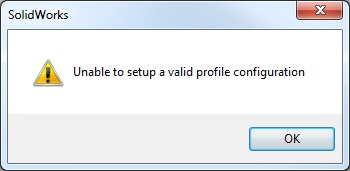

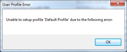

  • In one particular user case I receive two errors during the launch of Solidworks
Any ideas as to why this would be occuring? Are there additional modifications that we need to make to allow Solidoworks to running correctly in an environment with limited privileges?
