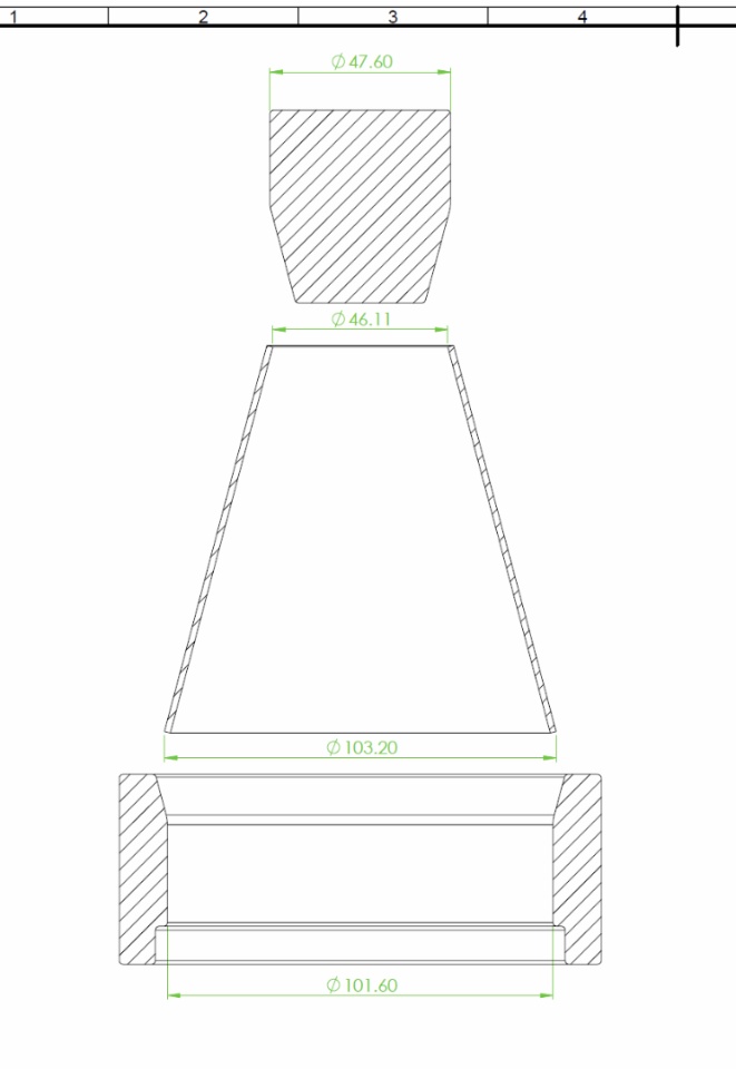

Is there a way to size the ends of a sheet metal cone using punch and die?
In the real world we do it as below pic, we form the cone from sheet metal, then we just press the punch through the top and the cone through the die and it flares out/squeezes in to correct size.
I'd like to be able to replicate this procedure in SW.
Sample files attached.
