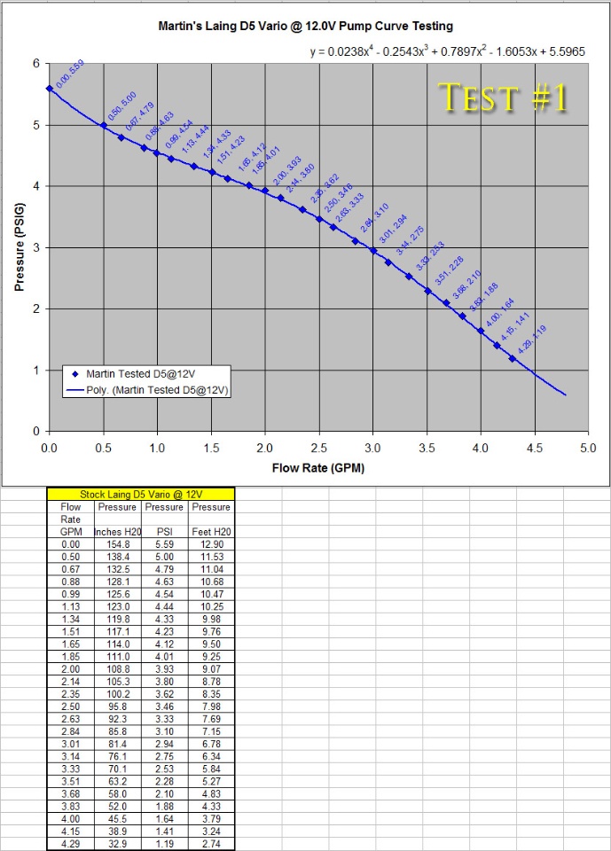

I want to simulate my PC water cooling system in SolidWorks symulation.
At the moment I have problem with recrieting pump in system.
At the moment I made closed loop with internal fun to generate flow.
My problem is:
I do not rally know how to simulate pump at the moment.
Pump in the system was tested on this forum:
http://www.xtremesystems.org/forums/showthread.php?170217-Some-Laing-D5-Testing-13-1-24V-is-the-same
Official product info for EK D5 pump:
- Maximum pressure head: 3.9m
- Maximum flow: 1500L/h
Is this correct way to test pump for SolidWorks simulation.
If so How can I convert it to usable data?
Regards Arek

I understand that to get proper parameters (pressure difference) to simulate pump in loop, I would need to add other inlet of the manometer before the pump?
Is that correct?

Are you still working on this simulation? What you need for your model is an internal fan. This is from the official online help documentation, available inside the software:
