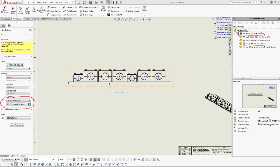

Pulling out assembly properties in a drawing view
Is it possible to pull out assembly properties (File Name, custom properties) in a drawing view, rather than its part only properties?
My current view below is show with the balloon feature, and it only pulls in the part properties.
Is this something that could be done with a balloon? or maybe with a \\\$PRP Note?
Thanks
