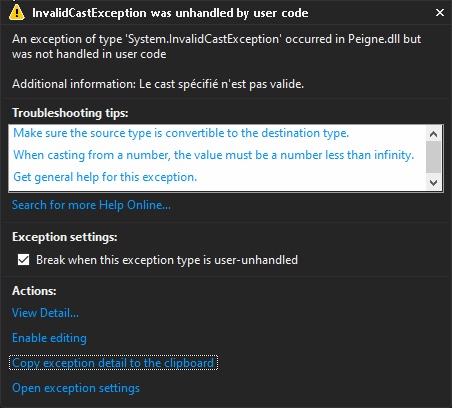

When I create a property manager page from a VSTA3 C# macro, an exception is thrown:
System.InvalidCastException was unhandled by user code
    HResult=-2147467262
    Message=Le cast spécifié n'est pas valide.
    Source=mscorlib
    StackTrace:
        à System.StubHelpers.InterfaceMarshaler.ConvertToNative(Object objSrc, IntPtr itfMT, IntPtr classMT, Int32 flags)
        à SolidWorks.Interop.sldworks.ISldWorks.CreatePropertyManagerPage(String Title, Int32 Options, Object Handler, Int32& Errors)
        à Peigne.PrpMgrPage..ctor(SldWorks swApp) dans c:\\...\\PrpMgrPage.cs:ligne 24
        à Peigne.SolidWorksMacro.Main() dans c:\\...\\SolidWorksMacro.cs:ligne 16
        à Peigne.SolidWorksMacro.Execute(String strDebug) dans c:\\...\\SolidWorksMacroStartup.cs:ligne 21
    InnerException:
        (null)

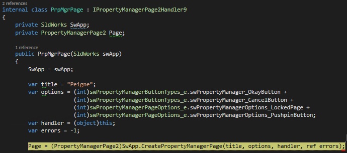

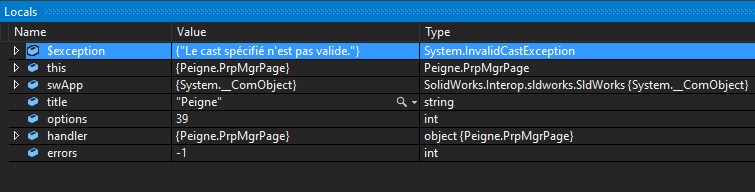

SldWorks::CreatePropertyManager arguments seems valid (type and value) but an InvalidCastException is thrown.
Any idea to solve this problem ?
Regards
Edit:
The InvalidCastException does not concern the PropertyManagerPage2 cast.
The exception is thrown on SldWorks::CreatePropertyManager statement:
