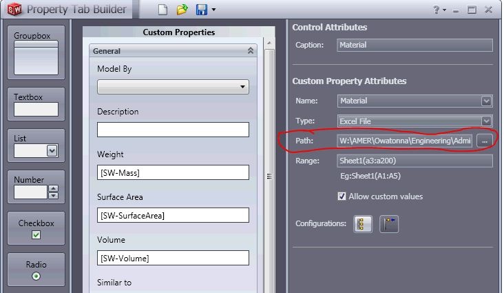

I have 2 office locations (one in MN and one in MI) that i install SolidWorks at. I currently create the image and then copy the entire image to the MI server. Works well, until I started using the property tab builder for or file properties.
I have a excel spreadsheet that has all our data in it for the property tab. It's located in MN. When I load SolidWorks in MI, it still points to the spreadsheet in MN.
Does anyone know if there is a way to change the path of the spreadsheet BEFORE i install it? What i eneded up doing was installing it on a PC in MI, then doing a gotomeeting and changing the path.
Thanks...Rob
