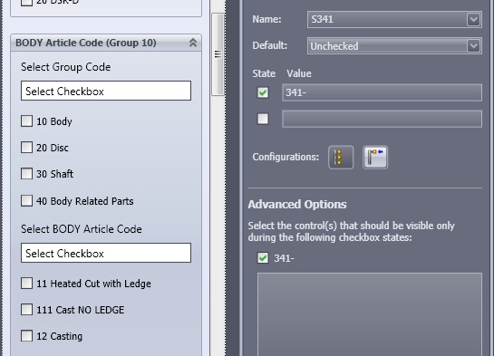

In the 'All visible' screenshot, all is OK

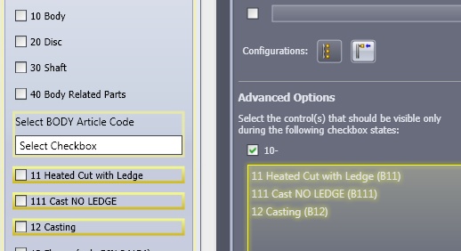

In the 'Only visible' the problem comes up...
