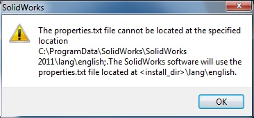

Properties.txt can't be found after upgrading to SW2012
We upgraded to 2012 version of SW and I noticed that when I right click on part file in my assembly and choose Configure Component that it displays a message about not being able to find properties file.
I searched for this problem on the forum, but was unable to find anything recent, I do beleave this was caused by the upgrade, but I'm not 100 positive.
I don't understand why it's looking up 2011 version if 2012 is available.
I looked for that directory and \\lang\\ is missing, so no wonder it couldn't find it.
I looked under 2012 directory and there it was.
I'm not sure if it would be OK to just copy 2012 \\lang\\ directory to 2011.
I'm not sure of what kind of functionality I'm missing with this error, but I just want it fixed.
