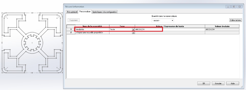

I've set up custom profiles of aluminum extrusion I often use. Each profile sketch is for one specific model of extrusion.
I would like to set properties at the profile sketch level for things such as :
-supplier
-partno
-material
etc
such that when I use this profile in a weldment, the info is propagated to the structural member.

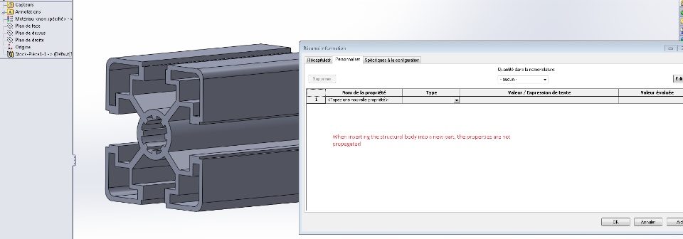

Next, to do drawing detailing, I use 'inset into new part' on each structural member, so that each member can be detailed on an individual drawing.
I would like the properties I set in the profile sketch to be available all the way down to the drawing level so that when I insert the part on the drawing, the title block is automatically populated, just like any other part.
Is there any way to do this?
I currently have custom properties set up for parts, and I use a custom property tab for parts, however, I haven't set up custom properties or a custom property tab for weldments.
