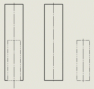

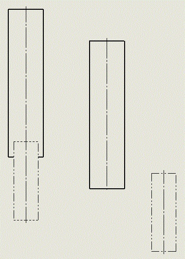

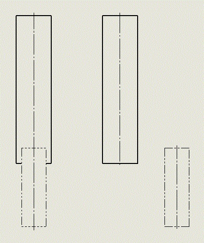

This is example of assy with enveloped component.
If components are not aligned relative to the top plane (for example) we`ve met this bug.
Projection after show enveloped (BUG)Projection before show enveloped (OK)Components are aligned (OK)
