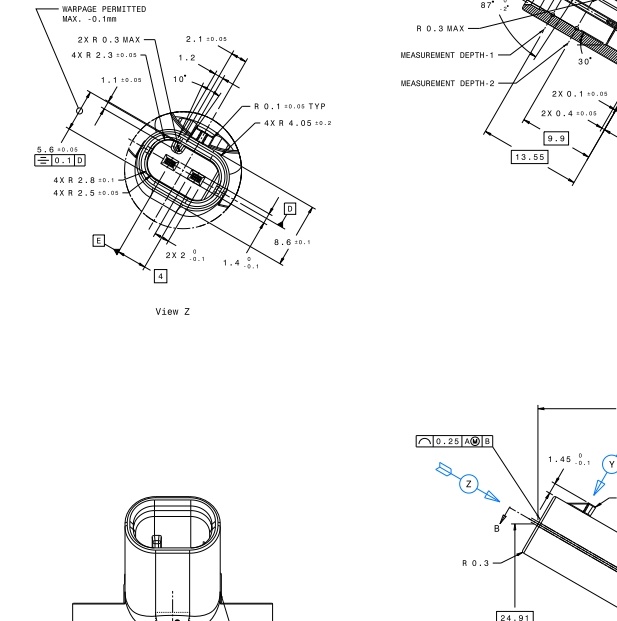

Is there a way to use a different symbol for projected views? In the fisrt picture is the only way I can get SolidWorks to show View Z.

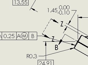

I've got a drawing to copy that uses the Z projected view arrow in Picture 2. This way uses less space. Just wondering if there was a way to do it. The second drawing was created using Catia, which I beleive Dassault also produces.
