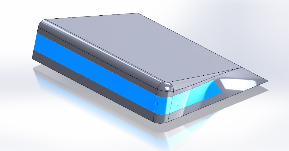

Does anyone have a good trick/technique for controlling lines projected on a variable surface? I am trying to keep the lines parallel and at a fixed distance (.42" is my goal). Picture a recess for a label that has a fixed height. I have tried using a split line (model attached) with ungood results. A wrap won't work on a lofted surface. Best I can come up with is just fudging the sketch for the split line until I get something approximately right. Maybe even more difficult, once i get lines projected well, I need to use them for an extruded cut normal to all the surfaces involved. Maybe can't be done? Thanks.
