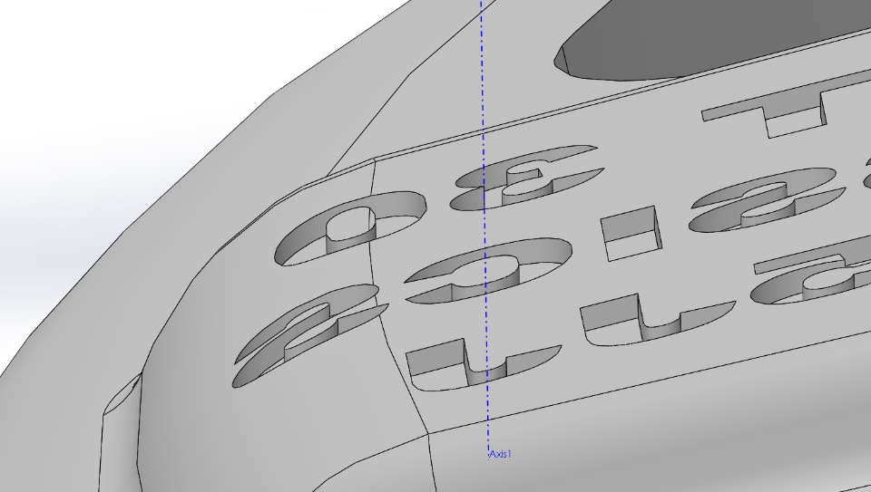

Project and deboss straightly on a curve
I need to write text on a curved surface, but the letters must always face a given direction
Wrap cannot be used as it makes the letters face the normal of the surface
Such geometry could not be machined on a 3 axial mill
The height of the deboss must be constant, just as seen on the wrap tool - not high on a point and low on another (as would be the outcome of an extrusion)
Can this be done ?
There's a picture:
A perfectly vertical axis denoting a vertical text on a curved surface
