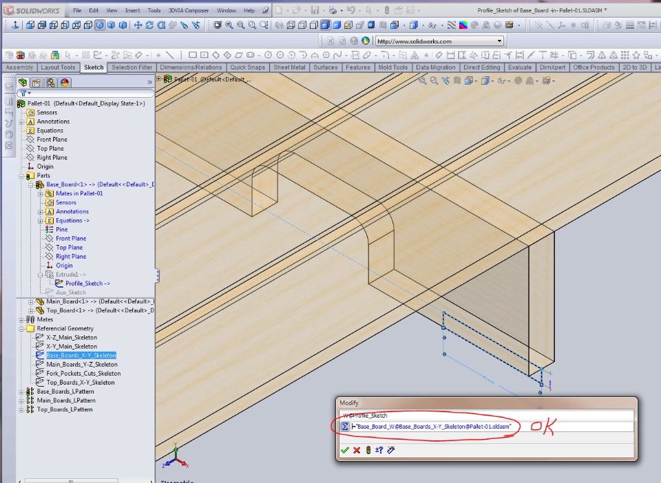

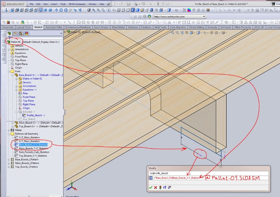

  • Can not create an equation to drive a dimension on a part level sketch using a variable (dimension, equation, etc.) from a sketch at a higher level assembly.  If on a dimension inside an sketch at the part level we enter "=" and then try to select a dimension from a sketch at the assembly level, the name of the dimension is copied "incomplete" (the reference to the assembly is missing) and SW do not allow to create the equation (see attached graph)
As you see on the graph a double click on the assembly level skecth dimension produce a "partial name" (... @Pallet-01.SLDASM) is missing and the entry is colored red meaning that the sintax is incorrect.
If the complete name of the dimension is entered by hand, then the equation can be created (see following graph).
