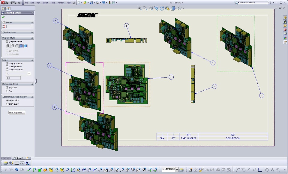

I am testing SolidWorks 2009 SP 2.0 for use at my company. Iam having a problem with getting a balloon to correctly report anitem number on a BOM while placed on a isometric view of a anassembly that contains a subassembly in the SpeedPAK configuration.All other standard views correctly report the item number in theballoon - its just the isometric view type that yields an "*" inthe balloon. All views have been explicity linked to the single BOMthat is in the drawing. Could anyone test this out for me? Here isa screenshot of the behavior I am seeing. All views that show an"*" are isometric views (either projected or a model view - I triedboth). I tried the trimetric and dimetric views and they werehappy....
