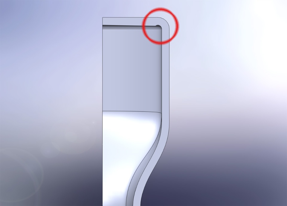

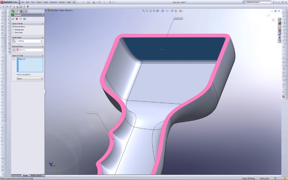

I used surfaces to create the shape of this part, and then thickened it to convert to a solid.  When I try to add draft to the inner top wall (see attached image) SW creates a nasty undercut where the fillet meets the drafted wall (see atached image of cross section).  Anyone know how to get around this?  I've never run into this problem before.
