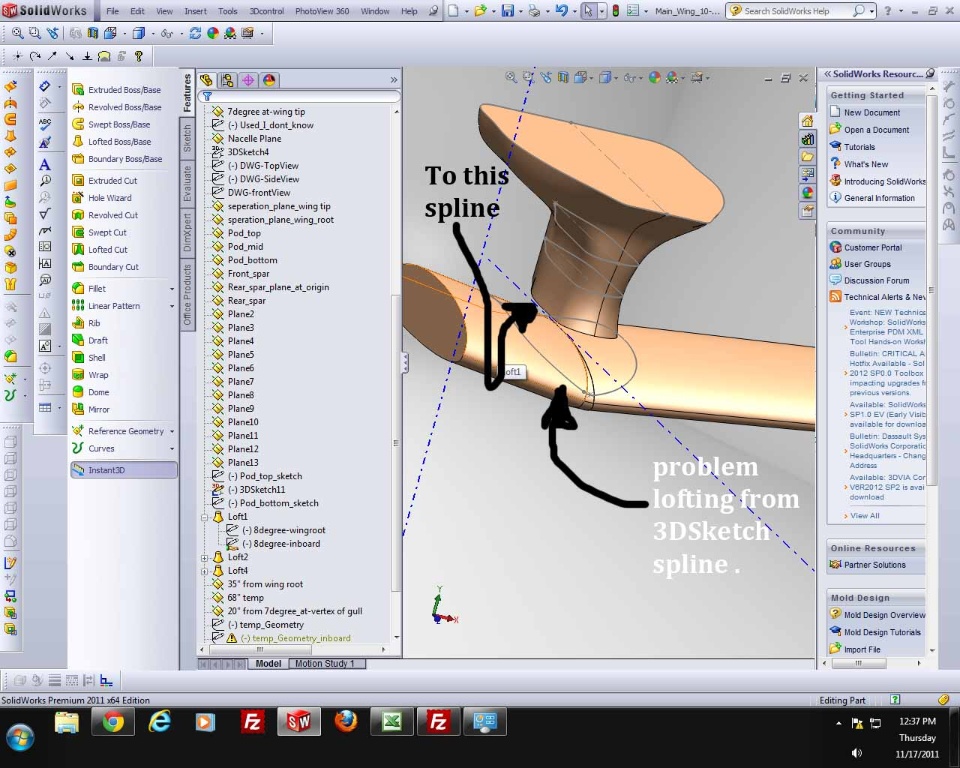

I am trying to design an Model Airplane wing component. I have lofted the wing with success. Then I have sketched a spline on the upper surface of the part. On another plane I have sketched a spline on a predefined plane. When I try to loft from the spline-on-a-surface to the other spline, I get an error. I am attaching the part with another loft above the wing. Ideally I would make one contiguous loft but the loft is having difficulty between the wing and the upper loft. I have made it work in surfaces, but I do not get the results I want. Here is a link to the file. I would greatly appreciate it if someone could help me.
