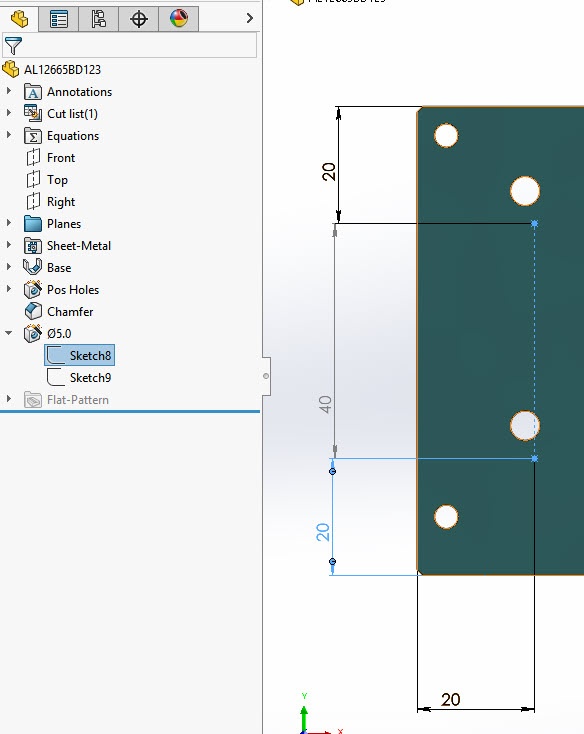

Every now and then hole wizard behaves strangely here. One of them this one.
As you see the hole position is different than its sketch. Rebuilding or ctrl+Q doesn't fix the problem. To fix the problem, I have to edit feature and only then everything back to normal.
Anyone else have seen something like this?
A sample file is attached.
SW2021 SP0
Any kind of advice is much appreciated.
