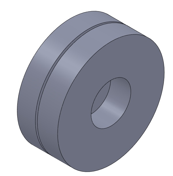

Hi,
I'm trying to select the following face of the attached part (sample.sldprt):
The code I'm using (after selecting the correct face using Entity.Select4(false,selectData) is:

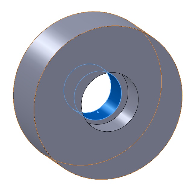

When debugging it, I can see, that first Select4 selects the correct face.
But SelectByID2 (which is required to get InsertMoveFace working) no selects the inner cylinder of the part:

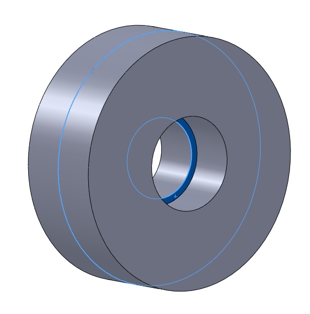

If I have no inner cylinder in the left part of the part (sample1.sldprt), the code works fine:
What may I change to get the correct Face selected by SelectByID2?
