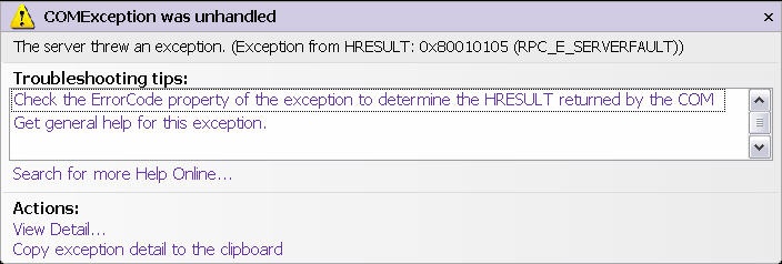

I'm having trouble trying to insert a smart component into an assembly using the API. I followed the example in API Help and everything works fine until I get to the swAssy.AddSmartComponent method. I'm getting the following error -
I'm using SolidWorks 2011 SP5. Here's my code -

        swComponent = swAssy.AddSmartComponent(strCompModel, dblSkPtX, dblSkPtY, dblSkPtZ) <-- The error occurs here
