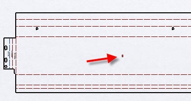

I have a program that exports a SolidWorks drawing to a DXF. The drawing has a block in it and when it is exported the block location changes. Apparently this is a bug in SolidWorks. As a workaround you can explode the block before you export it and the location doesn't change. My problem is when I try to programmatically explode the block it doesn't work.
This is what the drawing looks like before I explode the block

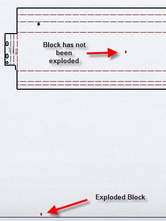

This is what the drawing looks like after I explode the block
My code is below. Any ideas?
