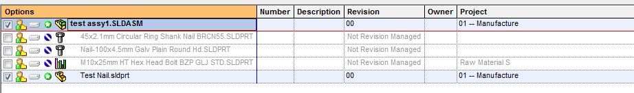

Today I had to make a new fixing (Test Nail) to add to our library & I noticed that when checking in the assembly that I didn’t have the library icon next to the new fixing (Test Nail) & it was going to check it in to PDM Workgroup as a new part (even though its set to read only in my library location)
I added the new fixing to our library in the usual way (r clicked the feature manage tree & add to library) & the new fixing appears in the same location as the other fixings
I did use the sldsetdocprop.exe application to change the flag to a toolbox part  off & on but that just changed the icon from a normal part to a toolbox part. I want my new Test Nail part to appear as the M10x25mm HT Hex bolt appears in this snapshot (as a library part in my Raw Material project)
