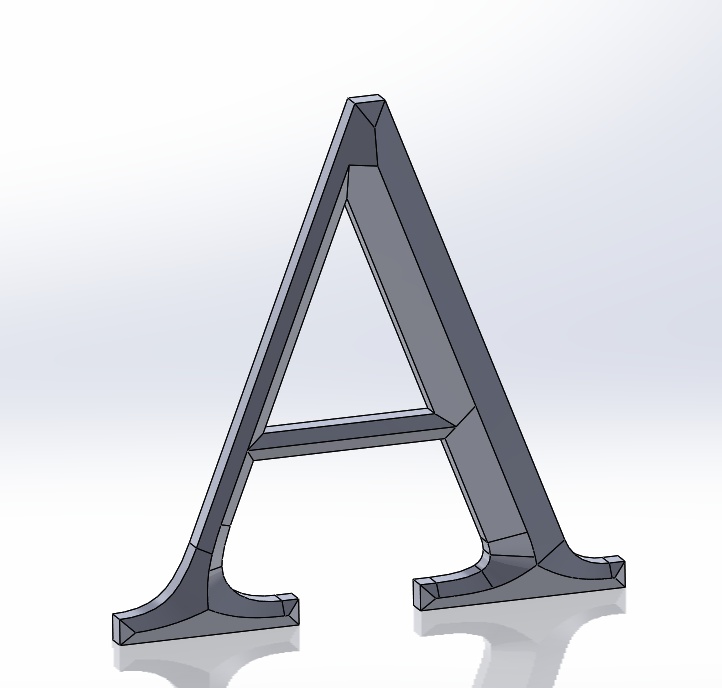

I've tried several techniques, but can't make anything work consistently. The "A" below was created with extrude, then extrude with draft. It worked.

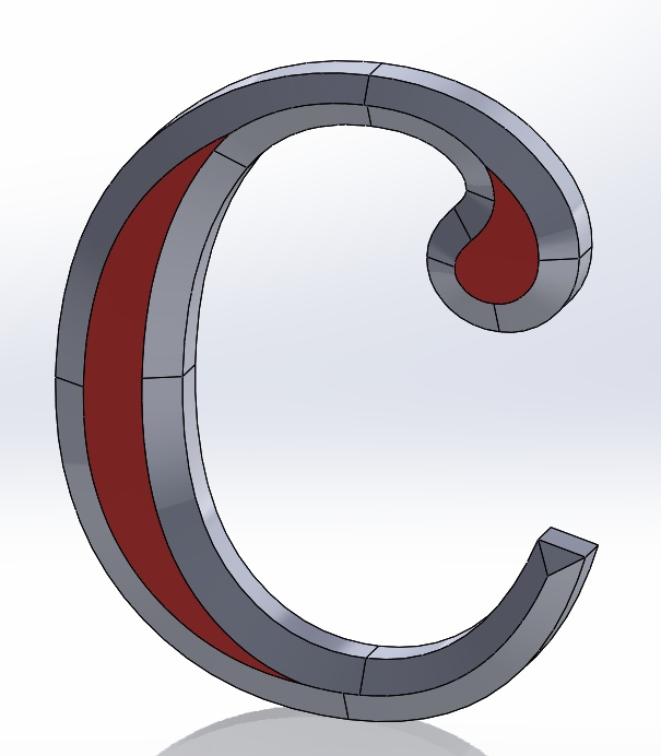

The "C" below was created using the same method, but I can't make it work. (The red faces should not be there). When I increase the height of the extrude beyond what is shown in the screen shot, the extrude fails (the geometry around the red tear drop shaped face puckers)
