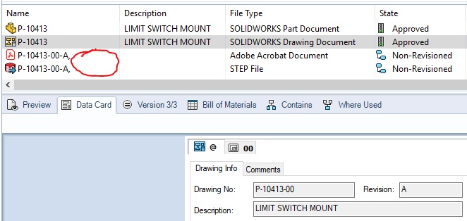

Print Task does not include description in file name
I want the Print Task to save a PDF copy of the drawing upon approval in PDM.
I have the task in the workflow
The part contains the description (not config specific) "LIMIT SWITCH" and is approved.
The PDF is generated, pulls the corrected description from SW, but does not include it in the file name like I want.
Settings in the task include %DESCRIPTION%, but it looks like this only pulls the "configuration specific" description. This part has no configurations, so it only has a "custom" description.
Is there a workaround for this?
