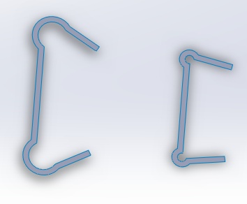

The purpose of this macro is to be able to select multiple surfaces from an assembly, and print out (to excel) the Area and Area Moment of Inertia (Ixx,Iyy,Izz) for each individual surface selected. For example, selecting both surfaces below with cursor, running the macro, and printing to excel each surface's respective Area, Ixx, Iyy, and Izz:
The code below works for one surface, but when multiple surfaces are selected, the macro is unable to distinguish between each individual surface, combines them, and outputs as if one selection was made. Any thoughts?
