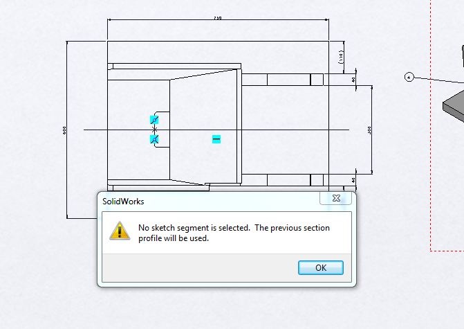

Always when I change a cross section sketch in a drawing to make it for instance coincident with a point (in this case placed manually on the midpoint of an edge) I get the message "previous section profile will be used", see attached.
The horizontal line is the cross section line being replaced.
I usually ignore this, since when I close the sketch it still does what I want it to do.
Can anyone explain why this message comes up?
Is my practice wrong here?
