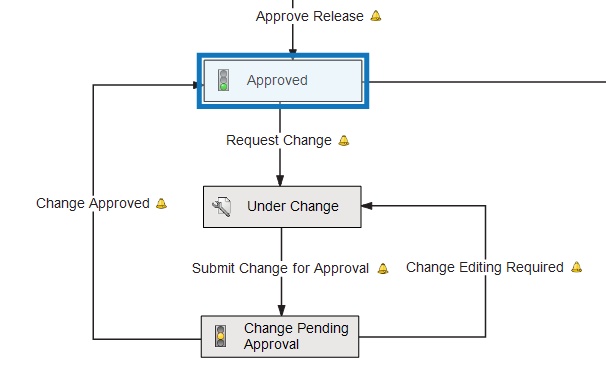

Or is this a workflow definition thing. In our workflow, there is a defined state for changes for Approved files (an ECR state if you will). Is there a way to define a state to not allow check ins?
