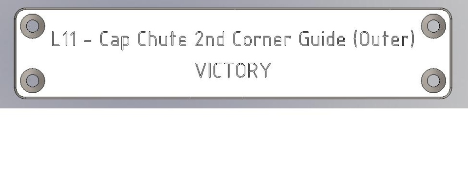

The attached part file is a sample of that which we often use here for labelling parts. These have always been a problem in that the file size for such an otherwise simple component becomes extremely laggy to deal with.
In the past I have inserted desired text and extruded the sketch to produce the "engraved" effect. I recently decided to try scribing the text as an alternative. Although this has helped considerably (this file used to be 35MB !!!) I'm still finding it slow to change configs.
Question is, are there any text styles that could be used that would reduce processing time to something more managable. We arent committed to one text style or another.
