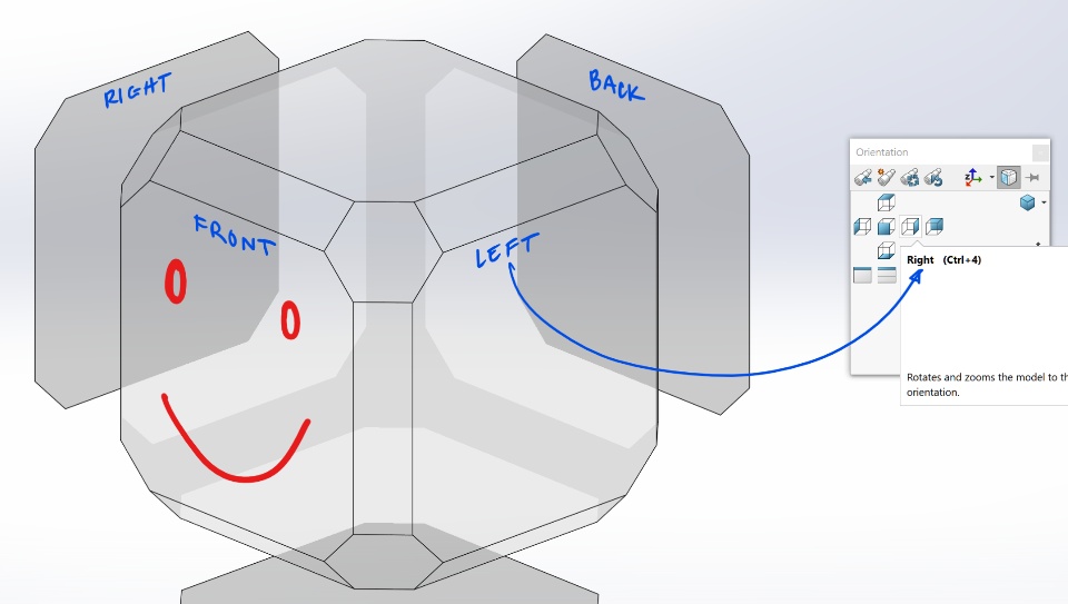

Is it possible to rename them so that "Left" is "Right"?
I'm struggling to use a Z-up orientation and getting all the views to match. I work in the automotive industry where the orientation is:
Z+ = Up
X+ = Back
Y+ = Right
Imagine the below cube was a head. If you click the "Front" view orientation you're looking at the face. But when you click on the "Right" orientation it looks at the left side of the face:
If I use "Update Standard Views" to correct the left to right issue then it swaps Front with Back.
