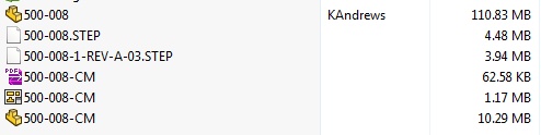

Now for the question...
The finished casting part has a file size of just over 10 mb. The casting has a file size of just over 110 mb (see below):
**500-008 is the casting
**500-008-CM is the finished machine part
Is there a way that I can condense the file size of the casting? While there really shouldn't be, I do see quite a bit of lag between working on the two simultaneously (two screens with both files open). I am hoping that by condensing the cast part, I can speed up the process.
